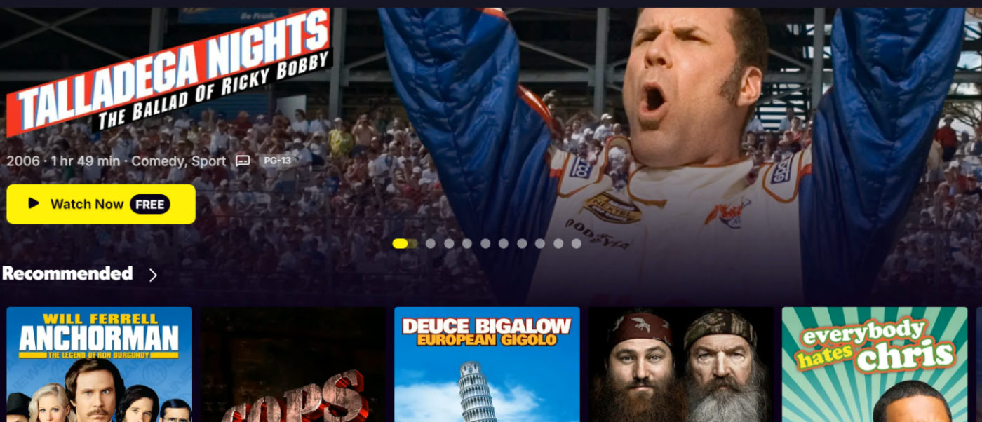

                  When you first go to Tubi they list a bunch of movies that change every few seconds. Talladega is one of them. If they click on it, it will play (whether you sign in or not). If you scroll down at that point, you will see what looks like the pop-up in #6 and #9. This isn't A/B testing, you just maybe never scrolled down to see it. But the key is, before you click to play, the Tubi Downloader box will appear like in the upper screen capture in msg #8. The Tubi Downloader also appears if you search for "Talladega" and click on the icon. I can't get the Downloader not to appear, no matter what I do. Could it be possible that they are using an ad/pop-up blocker that is stopping the Downloader from appearing?
Name:	Screenshot 2025-06-23 7.12.25 AM.png
                    As I confirmed in comment #22.1, I had only accessed two tubi URLs in SF.
                    I didn't navigate on tubitv.com, so I didn't have the option to follow a suggestion on their home page.
                    Now that I've been able to test it - it makes no different for me.
                    Not for me or not more (1st is Divergent) and there is no popup after click ..
                    .. I see the player and analyze window in foreground (like pic #8)
                    Even with Auto Analysis deactivated
                    Nope, I see never the pop-up like #6 or #9 with x top right to close
                    and disabling AdGuard (never active in my SF) doesn't change anything.​
