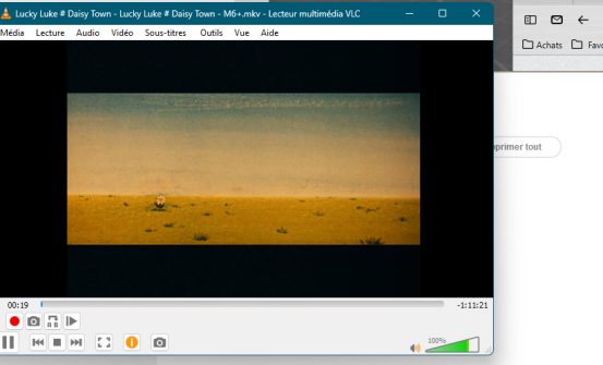

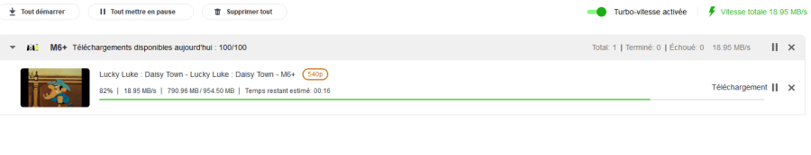

                      Hello, I try what you wrote: Luky Luke Daisy Town and I have the film in few secondes/ (pictures) (I use the last version 6.2.4.8)Click image for larger version
Name:	Capture d'écran 2025-08-08 123356.png
                      a,d after again:
Name:	Capture d'écran 2025-08-08 123447.png
                        #41
