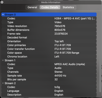

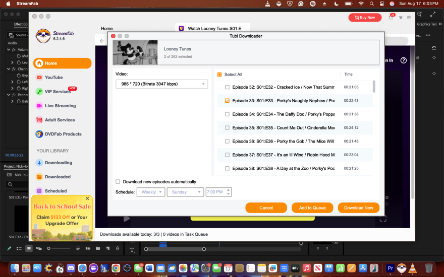

    Tubi offers Looney Tunes at 720p and I get it downloaded at 576p? Why?
    StreamFab.log the log file

          I am downloading now, and even there SF says 720P, so will wait till the download is finished.
          NOW finished MediaInfo:
          Click image for larger version  Name:	yBsavfi7RaeHUrYR1Dejfw.png Views:	0 Size:	2.2 KB ID:	467078
          So keying off the fact it's a non-standard resolution for 720 then Mediainfo must want to show it as 576.
          So I don't think it's worth discussing differences in 4:3 or 16:9 or whatever, the best video resolution, via MediaInfo they will get, is above in the screenshot.

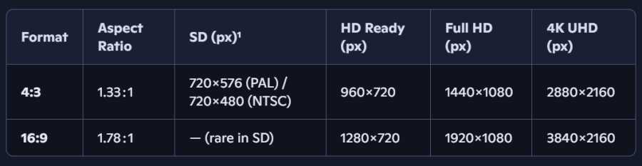

              It's quite simple. There are basically two types of TV formats: 4:3 and 16:9. 16:9 also includes the extra-wide cinema formats.
              Therefore, for example, 1920x800 also actually falls into the 1080p range, meaning it's also Full HD.​

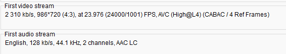

                      If I select 986x720 (correct info in m3u8) with SF (for Win not Mac) I get also 790x576
                      Code:
                      [Info]: [Analyze Dlg]:  Record add to queue -- Resolution:  "986:720:3047401"
                      [Info]: AddVideoItem max resolution (790 x 576)
                      > Why?
                      Because CEF (Browser in SF) can't get max resolution ..
                      .. find the difference:
                      Offer in current Chrome
                      Offer in current SF

                            Yes, the Google AI info took this way off. When the SF download window pops up, it says 986*720. Even while downloading, it says 720, and that's what most would think they are going to get.
                            Instead, it gets 790*576.
                            So OP may have to accept this, as I highly doubt SF sees this as a high priority to try to fix, if it's even possible to fix in SF, although it is a bug in SF.

                              I still don't get why the quality lists 720p available on SF when I can't get it?
