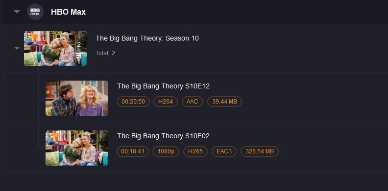

          just tried season 10 episodes 1/2/12 if you want to give it a try.
          ep 1 : h264-720p / h265-1080p
          ep 2: h264-720p / h265-1080p
          ep 12: h264-1080p / h265- failed? size 39mb and its something entirely different
          Click image for larger version  Name:	vlcsnap-2025-09-03-21h33m09s243.png Views:	0 Size:	106.7 KB ID:	467781Click image for larger version  Name:	hboxbig.jpg Views:	0 Size:	51.1 KB ID:	467782
            s10e12 in H264 1080p works fine for me
            but I needed a second try (first try only "Waiting for Download")

                    UPDATE: After checking all downloads seems HBO is a mess at least for this show. apart from mixed 720p/1080p episodes i found several small sized 30-45mb videos as the one showed in my previous post. And to get the correct episode had to analyze each episode separately and its naming was different without season/episode numbering.

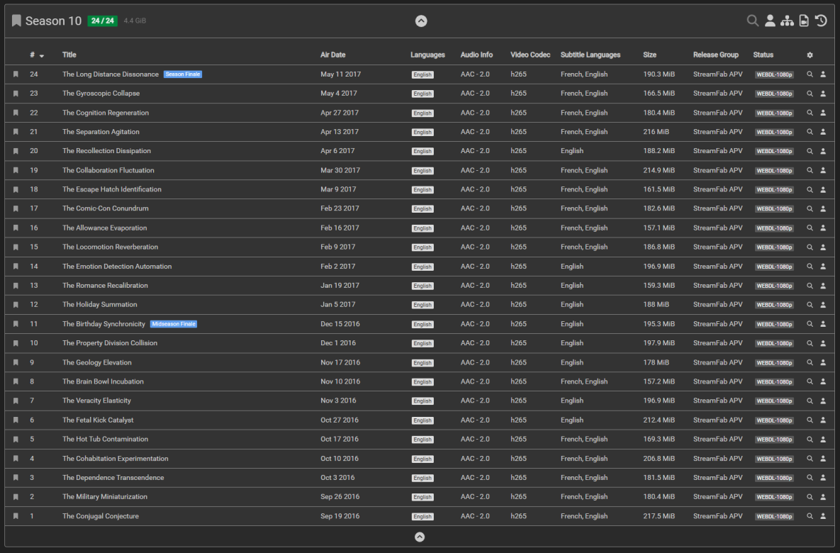

                      I downloaded all 12 seasons of BBT in 1080p H265 off PrimeVideo in June 2024.
