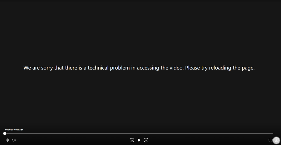

    Overnight I have not been able to play and hence download any sites that the DRM downloader works with. The main ones for rme have been -
    Experience the DFB-Pokal and other German football content on DFB Play, live, for free and on demand.
    Anyone faced any issues? Content plays fine in external crhrome browser

    Also note seems to be effecting Disney+ as well
      Many DRM MPD/M3U8 sites no longer work with 6256 ..
      .. if this affects you switch back to 6255

        yes now it is working for 6.2.5.5 Version so I say something was introduced in the latest build

              Hi all,
              For the DRM problem, please try the test version and tell me the result.
              https://dvdfab-temp.s3-ap-northeast-1.amazonaws.com/download/StreamFab_x64_6256official_2025_09_28_12_13_42_uti lity_tool_dev_vs2019_streameta_dev_vs2019_ec6fb09b .exe
                I can confirm that this has fixed all 6256 player issues:
