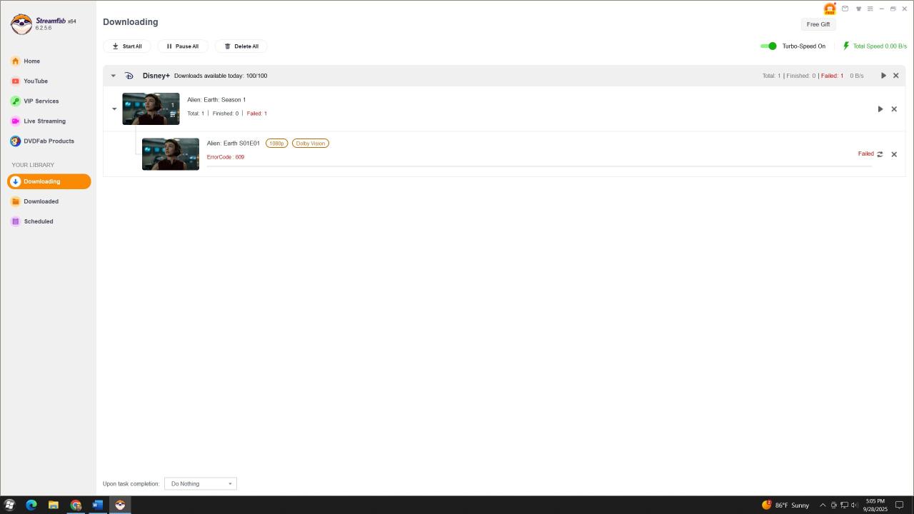

    Getting this error on Alien Earth. It seems to DL okay but fails processing. I've tried MP4, FFmpeg and ToolNix. It works on H265 SDR but I prefer DV. New Test Version in the US no VPN.
    Can someone else check their results.
    Thanks
    Here is my log
    StreamFab.log

        From your log:
        Code:
        [Info]: [CWV.CMutualCDMServer] Get value is empty! kid  9E6359372F7E4CAF9311423EC19CF03A
        [Critical]: [DC.Base] Dec video:  "... /Video_00/vt_00" encrypted
        [Critical]: [DC.Base] DecryptBinarayFile failed.
        [Critical]: [DC.DisneyplusV2] **** Decrypt stream fail.
        So it's a decryption problem - not a remux problem​

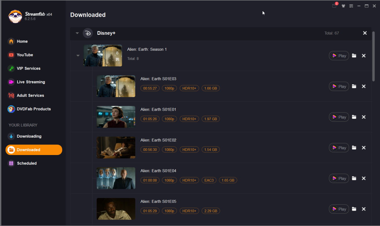

          No problem from Disney+ Canada
          Click image for larger version  Name:	image.png Views:	1 Size:	253.1 KB ID:	468845
          My Disney+ Canada account works in the US so maybe it's the same where a US one would work in Canada...
