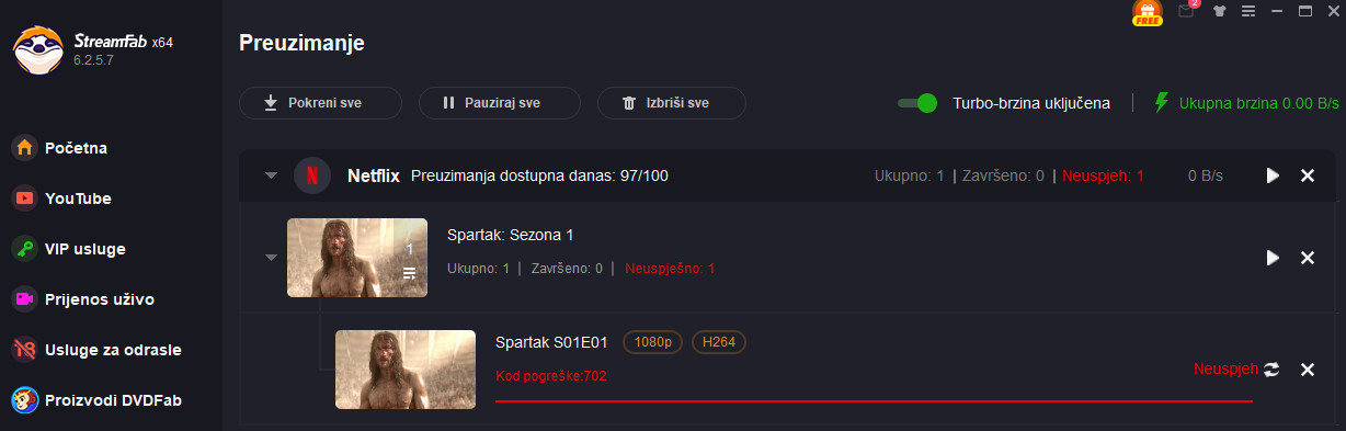

In the newly added series Spartak gives error 702 during processing. SF6257.
Error 702
Using from Croatian via VPN UK ?
I tried via VPN UK and your settings MKVToolNix and VP9
Looks like VP9 is offered in FHD
But the offered bit rate 1080p 3140 kbps is not VP9 - it's H264 ..
.. and I get the same error
All Video Codecs offer the same H264 info (no H265 offer) ..Code:[Critical]: [DC.Netflix] IsBadFile : "D:/Download/SF__Temp/outputTemp/Netflix/ ../video/637143511" [Critical]: [DC.Netflix] "bad encrypt stream (1)" [Critical]: [DC.Netflix] Decrypt video stream failed . [Critical]: [DC.Netflix] remuxDownloadedFiles not found video stream
.. and I don't know why, but looks like the stream is corrupt.
