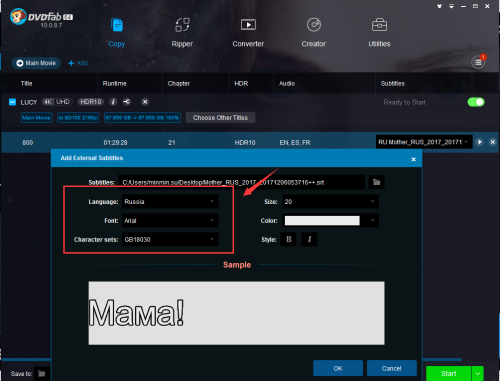

            Hello, and support for the Russian subtitles.
            I put Code:GB1830, lang:Russian. with this encoding, Russian subtitles are not displayed at all.
            please make support for Russian language.
                Regarding this problem, we have tested with UHD Copy- Main Movie mode with external Russian subtitles, we do not reproduce this problem. In this case, please list every steps you take, and send us a copy of external Russian subtitle, so that we can follow all your words to reproduce this problem. Thanks in advance.

                  here shaking here mom.
                  here Russian subtitles shaking here.
                  the encoding set. GB1830
                  on the sample. show up the squares. no Russian subtitles. help please! recommendation.

                    We check on our side, it works. A copy of subtitle has been PMed to you, please kindly check and follow the settings as showing on the image attached to try again.

                      I'm sending you a picture. there are no Russian subtitles. only squares.
ID:	351732 that's sent a picture. with Russian subtitles.in the form of squares.
                          Hello,
                          The picture you posted is a bit small to check clearly. Anyway, here is my settings, please check screenshot below.
Name:	subtitle settings.png
                          Language: Russia
                          Font: Arial
                          Character sets: GB18030
                          And here is the copy of .srt file:
                          Please kindly check and try again.
                          Regards,
                          Mona
ID:	351815 that's sent a picture. with Russian subtitles
                              @vitaei
                              Please try again with the latest version of DVDFab, with the subtitle file I sent you in the previous post. If still have problem, please post larger screenshot. We can remote check your PC to check it out for you, you can contact us via online help system at http://www.dvdfab.cn/contact.htm
