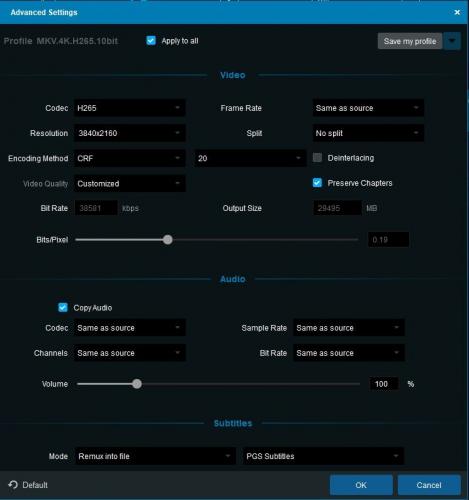

            We do not reproduce the problem. Please take a screenshot of settings in the advanced settings window and post it here.

              That is interesting, as I have run this a number of times and it is all the same larger size file. I have attached the screenshots here.
