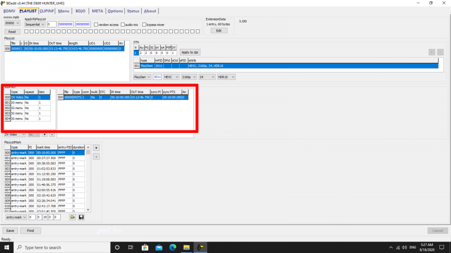

    I use main movie DVDFab 11.0.9.4 with the deer hunter uhd. This files is IG menu structure. After process complete, I burn and play on player. But player can't play and no problem when play on computer.
    I check structute on bdedit program. It shows dvdfab doesn't remove IG menu pop up from playlist (mpls) file.
    So I use bdedit delete IG from mpls files. And I burn and play on player, It plays fine.

            I think dvdfab don't remove IG Menu popup because dvdfab look them are dolby vision subpath.
            See picture

                I had to do a two step process in order to make a BD/UHD50 back up of Total Recall. I used TS Muxer first to create a Movie Only version and then DVDFab to shrink the files. DVDFab on it's own would play fine on my PC but would not play on my Panasonic UHD Player.
                Looking at the playlist info with BDedit, shows that it was using playlist 00010.mpls to create the movie only BD50 UHD, and does not remove the the SubPath 001 entry IG Menu, referencing the 00029.m2ts menu file which no longer exists in this movie only UHD. The other 3 movie playlists all reference different m2ts menu files.
                TS Muxer automatically removes IG Menu data when it creates movie only files, so using DVDFab on this format will therefore produce the same correct playlist data, with no IG Menu references.
                With this 'no play from disc' scenario with non-Java UHD's, I do not see why the DVDFab Service Team requires any files to be sent for examination. The BDedit screen-shot provided of the playlist IG Menu data should be sufficient for them to stop their code from duplicating the IG Menu references from the original movie playlists.

                        The problem is not about burn speed or firmware player. It's about dvdfab does't remove IG Menu popup because dvdfab look them are dolby vision subpath. see picture above.
                        When I remove IG Menu popup by BDedit, It's play correctly.
