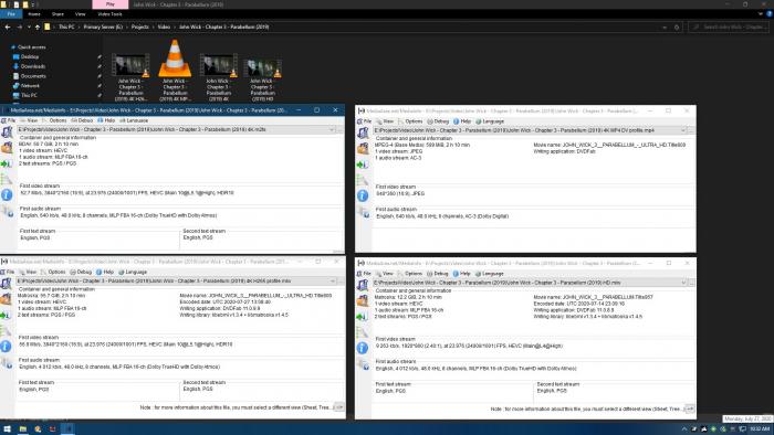

    I was reripping my movies and noticed that John Wick 3 was ripping only in "AC3 TrueHD/7.1 Atmos" and upon inspection using Mediainfo, it states 640kbs 8 channels MLP-FBA 16ch (Dolby True HD with Atmos) yet during playback on my receiver only Dolby Digital. So I reripped thinking it was user error and it ripped to the same thing. For the record, this is the only movies I have had an issue with. Yet?
    What is wrong?

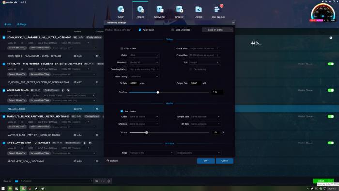

    3. Which profile did you use for the conversion? Please provide dvdfab_internal and fabcheck_internal log file for the process.

      Using Mediainfo on said output file, it states "640kbs 8 channels MLP-FBA 16ch (Dolby True HD with Atmos)" Which clearly is not Atmos only Dolby Digital 5.1 as the "640kbs" indicates.
      However yet during playback on my receiver only Dolby Digital 5.1 output.
      I am using a new Nvidia Shield TV pro with all settings correctly set for HDR and Atmos to a Denon H6300x to Sony Xbr - 900F via "EMBY" app which uses Exoplayer. I have been in electronics and pcs for 35 years and I assure you everything is setup correctly. I even swapped the hdmi cable knowing it was not the issue as ALL other titles played fine.
      So it appears this is only with Dolby Vision titles? I am looking into it further. I am using the m2ts and not the mp4, so that my have something to do with it. I will update after some testing.

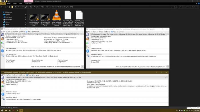

          The results are as follows:
          using the M2TS as my DV primary (previous editions of DVDfab ripped correctly and played correctly with Atmos track, HDR10) it would not rip the Atmos track as displayed in the attachments (current edition of DVDFab).
          MP4 DV profile did not rip at all?
          H265 4K ripped correctly and played correctly with the exception of DV, HDR10 provided as well as the Atmos track.
          I have attached the logs as well with the exception on the internal as it was too large. I will follow up using your instructions. I also attached screen shots of the test rips for comparison.
              Regarding this, which was the version that ripped correctly?
