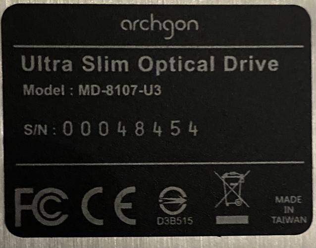

    I just purchased an Archgon external drive model MD-8107-U3 that appeared to be on your official list. However, it won't recognize 4K Ultra discs and I'm unable to downgrade the firmware.
Name:	archgon label.jpg

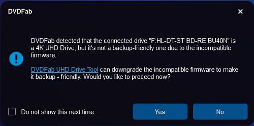

    When I open DVDFAB 12.0.1.5, it displays the following message:

    However, we I open the UHD Drive Tool to downgrade the firmware, I get the following message:

    First of all, I interpreted the info on your website to mean that this drive already supports 4K UHD. Secondly, DVDFAB displays confusing messages, first telling me that I need to downgrade the firmware but then (in UHD Drive Tool) that downgrade is not yet supported for this drive.
    Can you please clear up my confusion on this issue so I can determine whether I should return the drive or hold onto it and wait for you to support the downgrade of this drive?

        Doing a little research, I discovered a similar model MD-8107S-U3 (rather than MD-8107-U3) that is actually the drive referenced by DVDFAB as having official UHD support. Essentially, I didn't notice the missing "S" in the drive I purchased so I apparently bought the wrong one. Hopefully, DVDFAB is working on a solution to downgrade my drive.

              I believe you need the 'S' model. I just got the MD-8107S-U3YC-UHD model and it was recognized and downgraded. Works awesome
