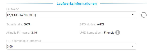

      Hey,
      the DVDFab Drive Tool says FW 3.10 and also states: UHD Friendly.
      So I assumed this FW version is UHD friendly - or does it just mean that the drive is UHD friendly?
      In the drop down list there are version 3.00 and 3.01 selectable.

      Anyway, shouldn't the drive try to read the disc at least? It doesn't make any noise.
        P.S. I do'nt know the manufacturing date, but I just bought it 2 weeks ago from amazon.
          The drive itself is friendly
          But ... Normally the FW version 3.10 (ex works)
          is not Friendly
          UHD kompatible FW = 3.00
          So steht das in den Laufwerksinformationen
          This is what the drive information says
            Ok, danke.
            Works now with FW 3.01
