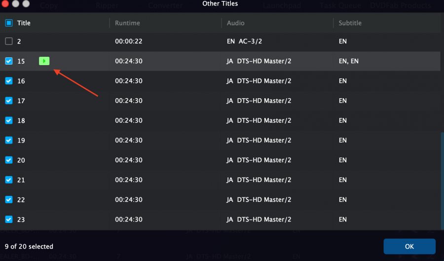

    So I am experiencing a number of issues so far with DvdFab and am trying to work through them. So my current issue is that the preview button looks like it should show a preview of the video but I am only getting audio. This is a bit of a pain because for whatever reason there are two duplicate titles of a show I am ripping. The first one I ripped the subtitles were delayed by like 5 seconds. The second title I ripped they were correct.
    Is this green preview button only meant for audio? I'm worried about using this to rip other series if there's no way for me to easily differentiate a bad or good title.

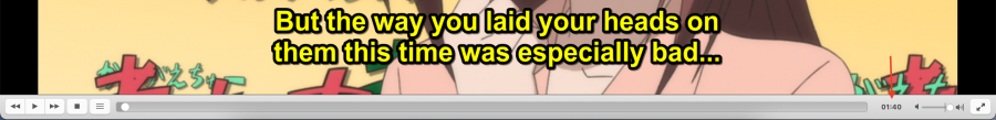

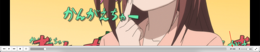

        In worse situations the subtitles just arn't there at all. I will attach two images with the exact same timestamp the one ripped with dvdfab has no subtitles displayed at the current time yet the one ripped with the other tool is displaying the subs properly.
