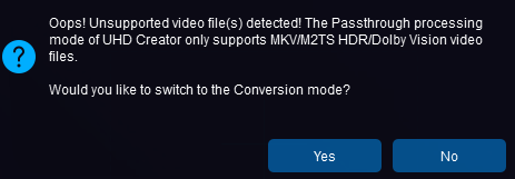

    After dealing with technical difficulties regarding limitations of Bluray authorization, such as:
    - h.264 wouldn't work for Blu-ray players, AAC audio format wouldn't be appropriate too.So, I've managed to export my videos with TMPGenc to get that widlely supported Dolby Digital audio, then I've reencoded my videos with DVDFab's converter to get the disred .mkv format with h.265, but I still can't use those files, and this massage appears: Click image for larger version
    I can't use my videos with "passthrough" option inside DVDFab's UHD Creator, and I really don't want my files to be converted one more time. How can I fix it for proper Blu-ray authorization?

          Originally posted by har2h View Post
          Unique ID : 240216494766379341050436389004757159483 (0xB4B803982AB2D475AE4CA8A82417CE3B)
          Complete name : F:\*\4K - to mkv (h.265)\Video\S01E01 - 23Mbps.mkv
          Format : Matroska
          Format version : Version 2
          File size : 3.38 GiB
          Duration : 21 min 56 s
          Overall bit rate : 22.0 Mb/s
          Movie name : S01E01 - 23Mbps
          Encoded date : UTC 2023-02-16 19:06:05
          Writing application : DVDFab 12.0.3.4
          Writing library : libebml v1.3.4 + libmatroska v1.4.5
          Where do I find dvdfab_internal log file? Thanks
          Please export the whole info and send it to us. Thanks.
            Hey, thanks for your support. In attachements you can find the whole info about this is slightly different copy (in terms of audio format) but converted exactly the same video as before.
