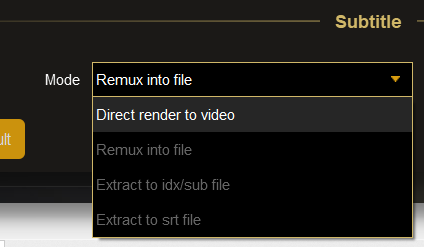

        Remux will allow you to enable/disable when there are subtitles in the file.
        To permanently put subtitles into the video, you would need the Render subtitle option.

          Thanks but I can't find an option for that if choosing mkv with dolby vision. Only with mkv with HDR. Is it not available with dolby vision?
            Is there a track that has the same language as the current one you picked? Please choose it to remux again and see the result .
              Hi, I tested all subtitles. Only choosing MKVHDR gives option to render to video for subtitles. If you choose default MKVDolby vision, there is only option to remux. Is this the limitation of the program. Can this feature be added. Thanks
