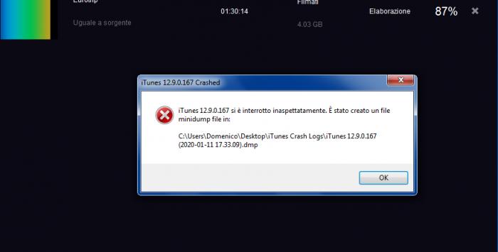

                Similar issue here,although the percentage it stops at isn't always 66%. For me, its got as far as 88%
                I get a pop-up that Itunes crashed, yet DVDFab says success and goes on to the next movie in the queue.
                Also iTunes v12.9.0.167 and DVDFAb 11.0.6.6.
                The attached log, both files had iTunes Crashed messages, yet DVDFab reported successful. Click image for larger version
