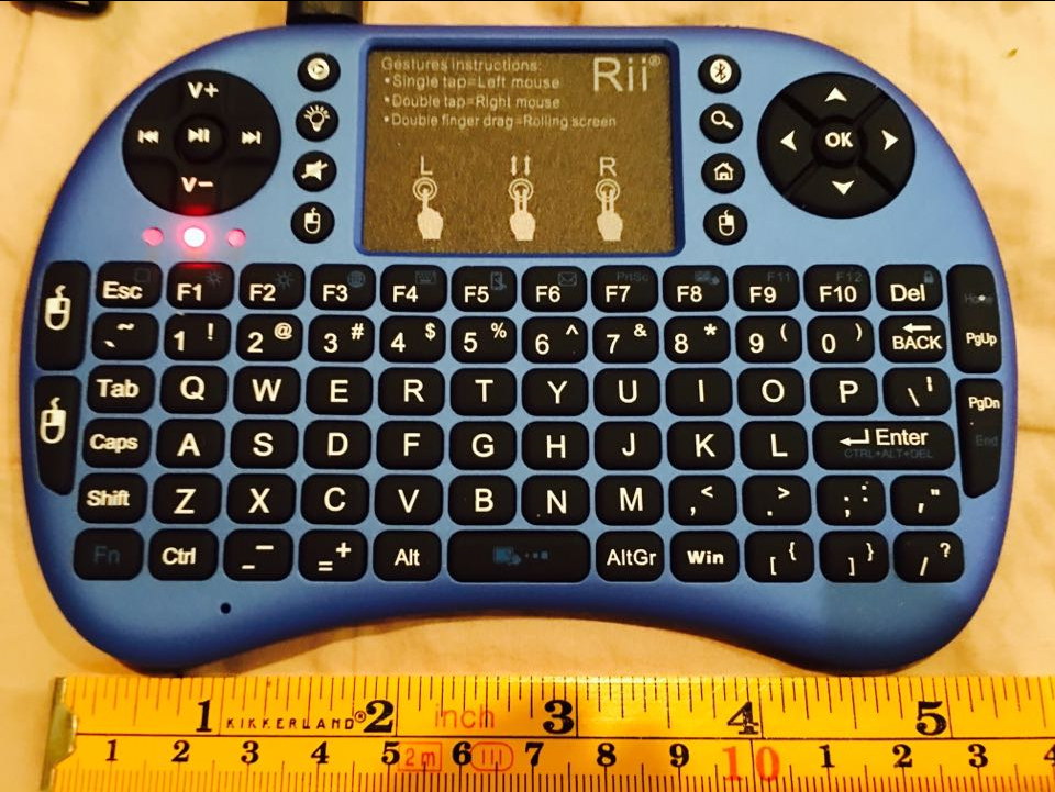

      I have the Rii Mini i8+, it does the same thing with the symbols, but ctrl+alt+del restarts the box and it will capture screenshots.

          Here is a picture of the one I mentioned in post #3, works well. It takes some experimentation to discover all the functions. The symbols (Shift+numeric keys) are not accepted and there is no way I have found to shut down the MS from this device. It's available on Tmart.com and Amazon in colors including DVDFab blue! The battery is a rechargeable and lasts a long time, and it links up with the MS very quickly. Range is 40-50 feet even between walls. <US$30 shipped. This should not be considered a company endorsement.

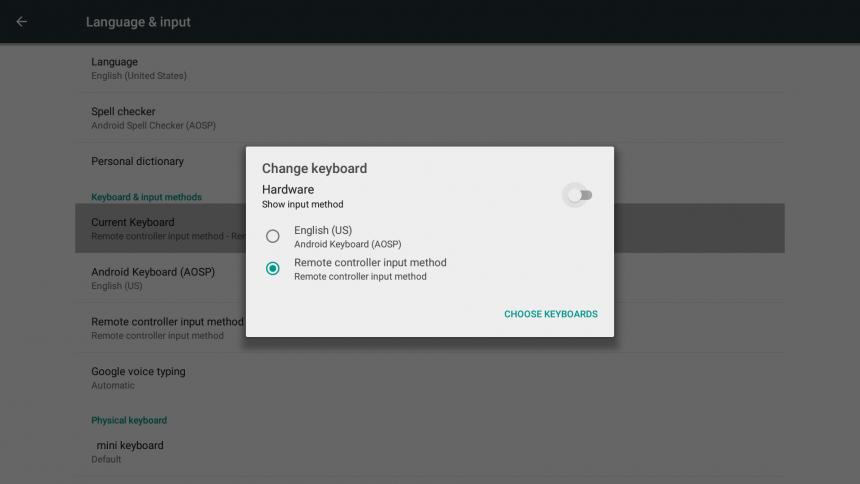

            Currently, I have a Logitech K400 Plus TV. I would like to get this to work. It seems to me that the MS is not interrupting the ASCII key codes correctly. All other functions are working correctly. The on screen keyboard does not have the keys that I need. Could it be a problem with mapping Chinese characters?

                Hi,mrfedora. You can close this option(show input method) to slove your problem.
                it works with my microsoft sculpt keyboard. Click image for larger version  Name:	screenshot_1502778892.png Views:	1 Size:	22.6 KB ID:	340182
                  It will be fixed in next version.
                    Thanks, Honeyjuice. I'll try it.
