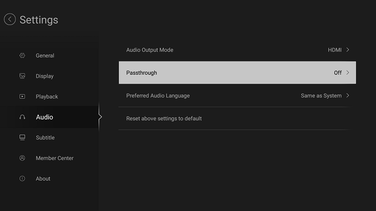

    How are you supplying the audio to the sound system (HDMI, optical....)? Try setting the audio to Passthrough if your sound system device will decode LPCM.
Name:	audio passthru.png

      I'm using HDMI passthrough and lpcm option is checked in the receiver compatibility list.
      Also tried passthrough 'off' and 'auto' options but that makes no difference.
