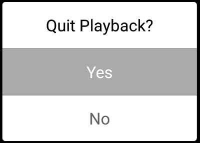

          I have done some further testing with the 1007 firmware, and for Resume to work correctly for me the following conditions must be met:
          1: You must choose Main Movie playback mode (or be playing a Main Movie rip, i.e. no menu)
          2: You must choose a stop playback method that shows this box:
          Click image for larger version  Name:	QUITPLAY_BOX.png Views:	1 Size:	9.9 KB ID:	341704
          (e.g. return,go back or ESC on a bluetooth qwerty keyboard). The Clear History button does not seem to prevent the working of future stop/resume point storage. Perhaps this can be improved in future releases.
