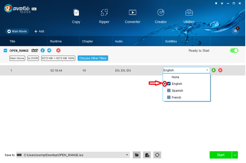

    DuaneS, one thing to check is if the arrowhead symbol is present the subtitles will be on by default, click it off and they won't: Click image for larger version  Name:	default_subs.png Views:	1 Size:	135.7 KB ID:	344521

      Duane, this is being checked, thanks for the feedback, Be sure to follow the example 90312 posted when processing titles and be certain the default arrow (circled in red) is off.
        Thanks Signals and 90312. I only use the Full Disc Mode and the subtitle option in DVDFab is not available. I have never found a reason to use the Movie Only Mode with DVD's. I just double checked this by copying another movie. The referenced subtitle option is available in Movie Mode and it is not available in Full Disc Mode. I don't know what default setting is used with Full Disc, so the problem remains.
