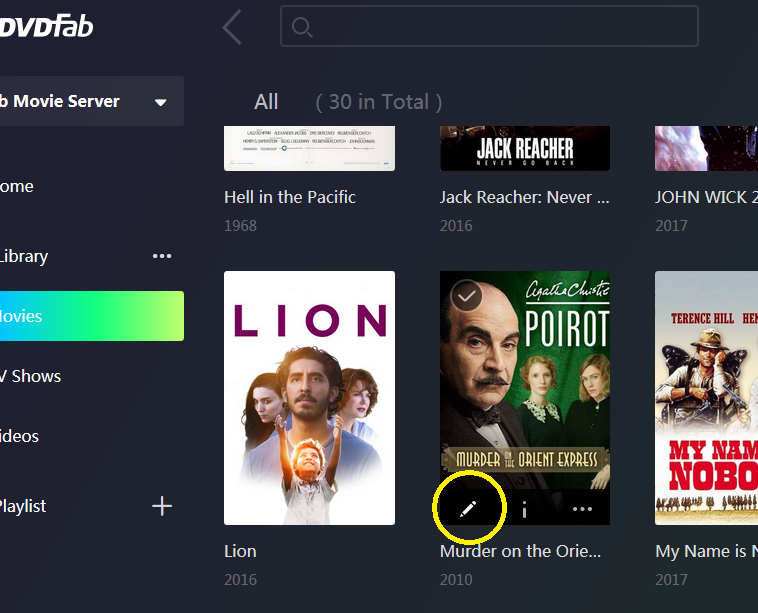

            There was an issue with Chinese naming with the v1012 firmware, but I have not seen it with v1013. You can try this: log in to the Manager at dms.dvdfab.cn and try deleting the Chinese country of origin if it is present in some titles. First open the title as shown here:

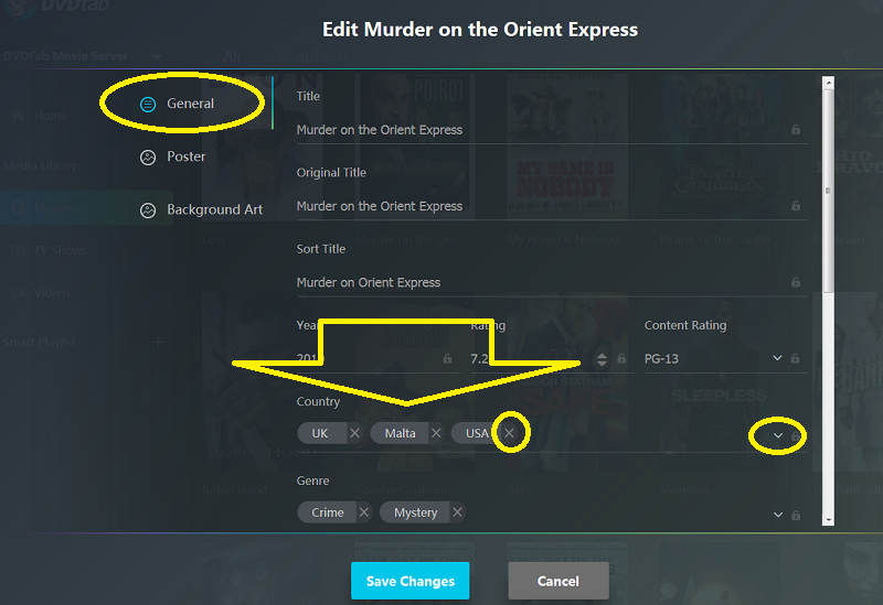

            Then click on the X to remove unwanted countries, or click on the small arrow on the right to add them, as shown below.
            Click image for larger version  Name:	1-011NEWMGR.png Views:	1 Size:	255.2 KB ID:	349919
