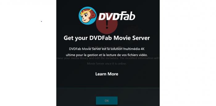

        But still the library managing WEB page "https://dms.dvdfab.cn/" is shaded out and display a "Learn More" page instead of the management interface. Again I can tell that all my three movie servers are powered and connected to the Internet. When will DVDFab staff solve this situation?
        Click image for larger version  Name:	Sans titre.jpg Views:	1 Size:	17.0 KB ID:	351547

            I know 1.0.1.0 is local thank you, but now it has been updated automatically to 1.0.1.3... and I have two other movie servers with 1.0.1.3 and since the beginning I can not do anything with the Movies or Series button menu.

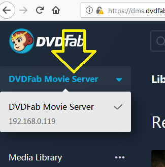

                If you have more than one DMS online, you need to choose which one you want to manage using the dropdown shown in this capture.
Name:	1-011 MANAGER_CHOICE.png

                  signals, Can't you see in my previous message above, I can not even reach the page you mention.
