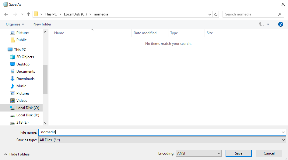

              OK, I created an empty file called DNI.nomedia and put in the root of the '\Documentaries' folder, this folder has a bunch of other directories in it...will that exclude all the sub directories?

                OK Signals, I either did something wrong or it doesn't work. I created a .txt file and then changed the extension to .nomedia. I copied the file into the main '\Documentaries' directory and that didn't work after rebuilding so I copied it into all the sub directories and that doesn't work either after rebuilding the library. Where did I go wrong?
                It just seems to me that the best way to do this is to have the option in the 'Edit Library' function to exclude...perhaps with a select/de-select type check box.
                  The .nomedia trick is an android function that should work. I tried it using the following steps and it worked as described
                  1. Open Windows Notepad, type nothing
                  2. Select File->Save As... and choose and enter .nomedia for the filename
                  3. Save it to a convenient location on your PC and move it to your DMS via the share or save it directly to the DMS if it is online, with the folder you want to exclude as the target location
                  All subfolders should be ignored as well.

                      So the filename is .nomedia and not the extension...got it. I'll give it a go!
                        Nope...that didn't work either. Just to be clear I did exactly what you wrote and named the file .nomedia.txt(empty file) with an extension of .txt(..default ext for notepad) because files cannot exist in windows without an extension. The file system on the 8 TB drive in the DMS is NTFS...does that matter?

                          I just tried it too, does nor work under windows.

                              Open Notepad go straight to the bottom and set file type to "all files (*.*) then type the file name above ".nomedia" and save. Works a treat: Click image for larger version
