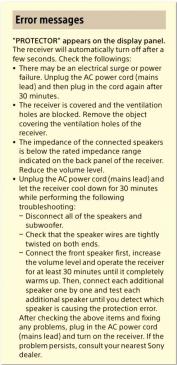

    Okay...so earlier this year I upgraded all my home theater gear to 4K. This includes the receiver(Sony STR-DN1080), Sony 65" Smart TV(XBR65X900F) and a Sony 4K Blu-ray Player(UBPx800). I also kept my Sony PS3 and added it to the system. The receiver has a 6 port in / 2 out HDMI switch built in, HDCP v2.2 compliant.
    I connected the movie server to the 'Video 1' port and defined it as a 'Net Player' in the receivers setup. I made sure to connect the HDMI output port designated as the 'ARC' port on the receiver to the 'ARC' port on the television(HDMI 3). The problem I was having was when I would watched a movie on the movie server as soon as there was a loud part of a movie, like a sudden burst of gunfire or an explosion the receiver would shutdown with a message on the VFD display that said 'PROTECTOR'. On power up the volume was set to 0. When I read the relevant material on this error message it lead to believe that it was a 'power problem' or a 'bad speaker'(see included pic). I have been dealing with this from the beginning and have tried moving the power plug off my line conditioner and moving the HDMI connection to different ports on the receiver and even tried going directly into the TV, same results every time. The movie servers audio setup was tried with 'Audio Passthrough' on/off with the same problem. Movie Server is at 1.0.3.7.

    make sure that you have the unit connected correctly.
      october262...I've spent the last two weeks making sure it was 'connected correctly'...which I'm not sure what that means exactly, it's the power cord and the speakers and I have the speaker wires clearly marked, they are also Sony. The power cord is connected to a high quality line conditioner. Every device connected to the receiver is via HDMI and good quality cables and they only connect one way. Besides, setting the volume level to zero on the movie server seems to have fixed the problem. I watched four movies that I know had tripped the software safety function after setting it to zero and had no problems.

        With Passthrough on, the audio stream is passed to the receiver via HDMI and is not decoded in the DMS (this is why the volume control does not work, that circuitry is turned off with Passthrough). I can't read the image you posted but your receiver seems to have extensive protection sensors built-in. A speaker protector guards the speakers and output ICs in the receiver against overload damage from such things as loud passages, broken/shorted cables etc. Sounds like the receiver gets too much audio from the DMS when the DMS volume is enabled and is set to 100.
          Hi signals, well if I am sitting at the home screen and not playing any content and use the volume control on the remote I can see the value go up or down. If I set the volume to 100 there and then go in and play a movie it will trip this protection function so just by empirical observation it seems as though this value is passed on to audio portion of the stream, by the same observation when I set it to zero and play the movie it doesn't trip this function.

Name:	Page 55 - STR-DN1080 Manual A.JPG
            This is a little more visible
              Signals, I guess the relevant question becomes when the unit is not playing content is the 'Audio Passthrough' setting applied or just when playing content? With the volume set to zero I get no system sounds when using the menus to navigate, which is no big deal to me. I went through the steps outlined in determining that all my speakers are good.
