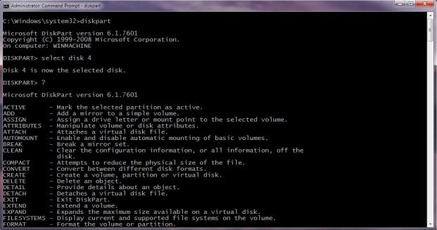

    ...command result
      #17

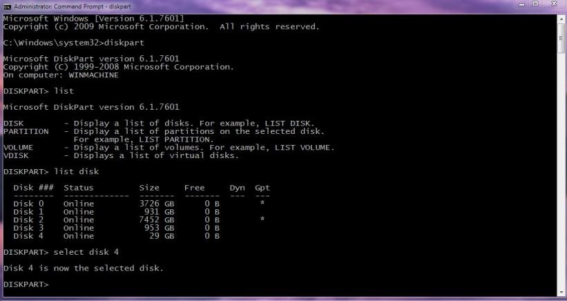

      ...notice how you are notified that the disk has been selected but the command prompt stays the same. Disk 4 in my example is the 'FOCUS' of the DISKPART tool at this point and any subsequent command will be performed on the selected disk.

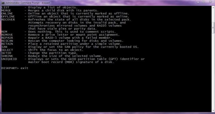

        #18
        The command we are after is the 'CLEAN' command. This will reset the disk of any and all parameters, including any corrupted disk geometry table which is what I suspect is wrong because I had got a disk from Amazon that had the problems as you are having and this was the only way that I could get the disk working. After doing this type 'EXIT' to leave the 'DISKPART' tool. Reintroduce the drive to the Windows environment and initialize the drive when prompted. Create a simple volume GPT partition for anything larger than 2TB then do a quick format.

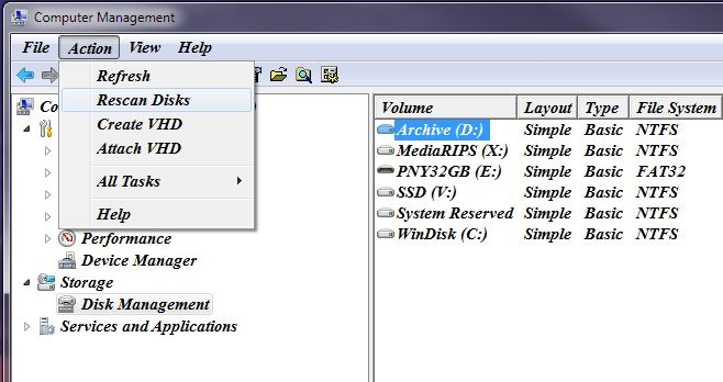

                    CPUTO...within the Disk Manager program there is a 'Rescan Disk' function from the action menu...try that and give it some time(2 min.).
                    The first thing that has to be done is the disk has to be initialized. No other operation can be performed on the drive until it is initialized...if you don't get the prompt to initialize the disk it is FULL STOP!
                    . Click image for larger version  Name:	7.JPG Views:	1 Size:	114.6 KB ID:	369524

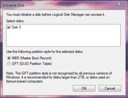

                      #25
                      CPUTO...this is the dialog box you should see. This computer I built has a 4 Bay SAT III back plane that is hot swappable, I inserted a 2 TB drive that I had cleaned some time ago. When I put it in a free bay so that I could capture the dialog box for this post I did not get the dialog until I launched the disk manager tool, but it did show up as a removable device.
                      . Click image for larger version  Name:	8.JPG Views:	1 Size:	63.0 KB ID:	369526
                      Until you deal with drive successfully within the Windows environment it is to early to say that the DMS is the culprit.

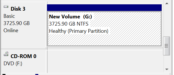

                        Dead Eye, you are impressive! I'm not particularly good a screen shotting, but the disk has been formatted, and the message in Disk Manager says:
                        "New Volume G:"
                        3725.90 GB NTFS
                        Health (Primary Partition)
                        So, now, I am going to switch off the DMS, install the HDD, and switch it on again. I hoped to see the new HDD when I went to Settings=>General=>System Maintenance=>Disk Manager on the DMS, and I got: "NO DISK DETECTED Please insert a SATA 3.5" disk drive to Movie Server first." So, I followed the "hard" rest instructions in the DMS manual: Turn off the DMS, insert paper clip into hole in back panel of DMS, keep inserted while turning on the DMS until the logo home screen appears. Got the little green Android man (standing up) whirring his antennae, and then the server home screen appeared. Went to Settings=>General=>System Maintenance=Disk Manager and got the same "NO DISK DETECTED... message. And when I insert a thumb drive into the USB slot in the DMS, it finds and reads it immediately. Now I have an "adapter" that holds my HDD and has a USB cable for attaching to my computer. I can try using thjis adapter and the USB port on the DMS to see if it will then see the HDD, but that is not a viable long term solution. I'm greatly appreciative of your truly impressive help, but I don;t know what else to try. Thanks!!

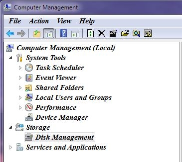

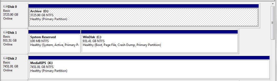

                          CPUTO...another thing, the Windows Explorer is not what you need to use to deal with 'NEW' disk. GOTO Control Panel > Administrative Tools > Computer Management > Storage > Disk Management.
                            #28
                            The steps are...Initialize Disk > Create a Simple Volume using the entire Disk(GPT) > then a quick format. There are different right mouse button menus available depending on where you click. If you right click on the box that says Disk 0 you get different options than if you right click on the hashed area that shows the drive label, letter and size.

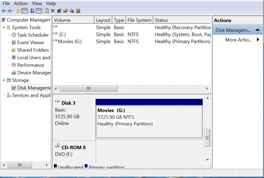

                              #29
                              I think I follow. I also may have gotten better at my screen shots:-) Below is a screen shot taken before I did any reformatting. The drive label is G: Disk 3. The second shot is after formatting. I gave it a new volume name "Movies" so that we could see that it was not the same as in the first screen shot.
Name:	Disk Mgr Opening.PNG
                              After Formatting:
Name:	After Format.PNG
                              I then inserted the formatted HDD per above into the DMS and got the same "DISK NOT DETECTED" message on the screen. Did I do it correctly? Thanks!
