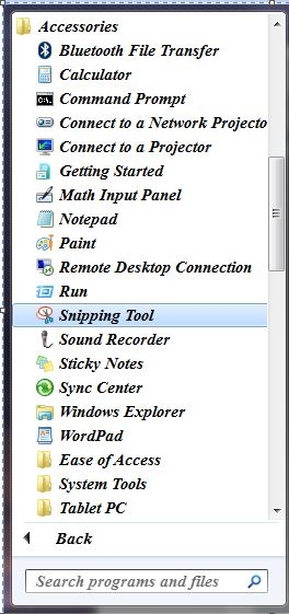

    I use a tool that comes with Win7 called 'Snipping Tool'...check your accessory folder...I pin it to the task bar. It freezes the screen then you drag and outline the section of the screen you want to capture. From there you save as a *.jpg to a folder of your choice, I created a folder called 'Snippets' and that is where I save them.

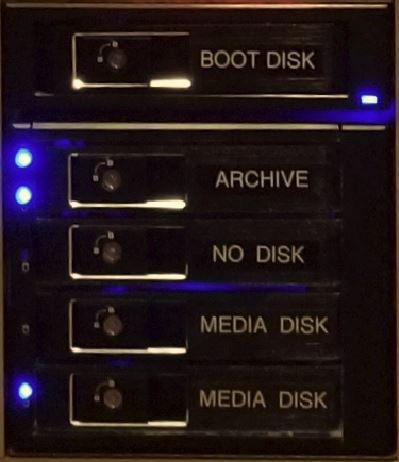

                Did you play around with that Snipping Tool? FYI...Microsoft is set to stop supporting Windows 7 in Jan 2020. I plan to start building up a Win 10 HDD soon and transition to it. The good thing is all I'll have do is plug it in to the drive bay...this is a PIC of the drive bays that I put in this PC I built, the boot drive bay is separate from the bottom 4...the second one up from the bottom is the one I keep free and is the one I used to set the HDD up for the DMS.
