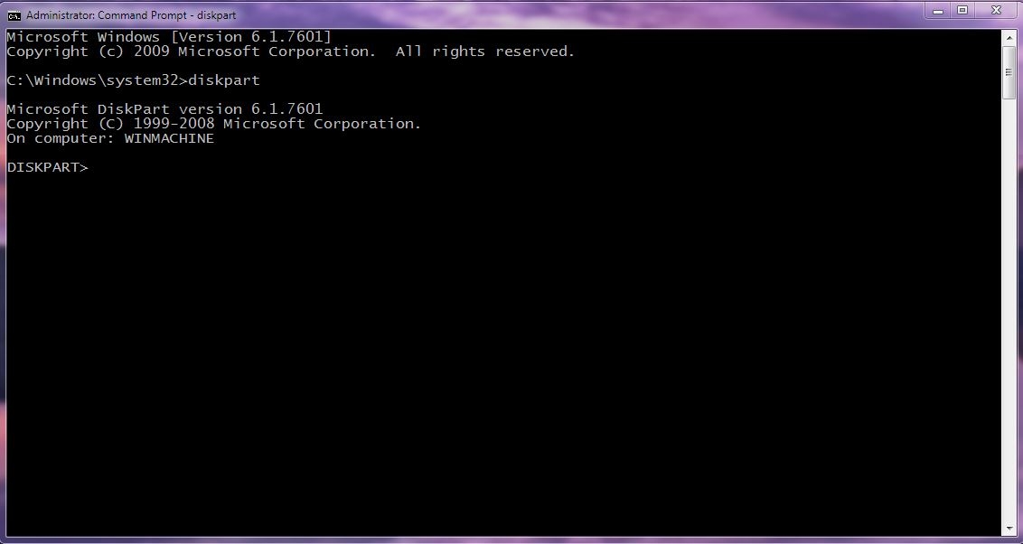

                          CPUTO...At this point I think it is time to try the 'DISKPART' command...First I want to warn you that you have to be very careful using this because it will absolutely destroy any disk structure and basically take the disk back to what it was coming off the factory assembly line. What follows is a series of screenshots showing the commands to clear the disk of all information. Maybe do a little reading up on it before attempting to use it. I am running Windows 7 but I think Windows 10 has the same command. Start with an elevated command prompt then type the DISKPART command

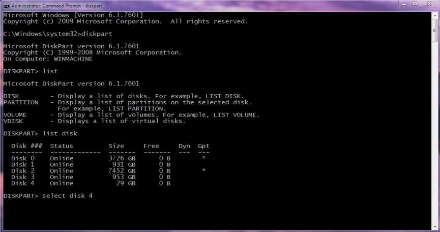

                            ...then type list disk to see all the disk on your system...for my example I selected disk 4 which is a USB thumb drive.
                              ...here is that command
