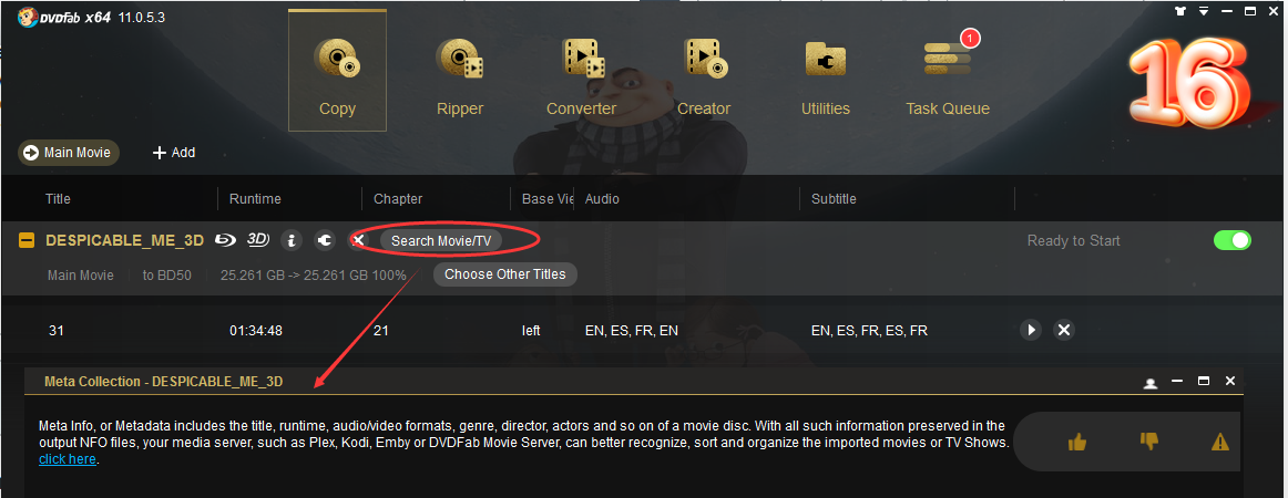

                  Hi johnw413, sorry for the delay in responding, please update to the latest version of DVDFab 11, it should work now.
                  Once the meta info of the movie is corrected, it should go from Video to Movies section automatically. You can also use the Search feature in DVDFab to correct it's meta before output.
                          I'm not sure what is supposed to be fixed. The "Can't Find DMS" or "Movies copied to Video"? DVDfab still can't find the DMS!

                            ---The "Can't Find DMS"
                            About this one, please attach the latest dvdfab_internal.log file and media.log file.
                            ---"Movies copied to Video"
                            As for this one, please refer to the previous posts, use the fix match feature of Movie Server or the Search option in DVDFab 11.
