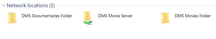

        The one with the green 'T' is the main share on the DMS(\\android_xxxxxx\share (..substitute the numbers of your unit for the x's), and the other two are commonly used folders on the DMS.
          As a helper Alex you should make a sticky note to stick on your monitor on your PC with the MAC ID of your DMS (..or the My Products page on DVDFabs website list the DMS by its MAC ID). From there you can bring up an Administrator level command prompt and type arp -a, this will generate a list that is the 'Address Resolution Protocol' table for your network per adapter. If not then reboot the DMS and wait a bit and do it again. You will see the IP address of your DMS with its MAC ID.
          Once you get the IP address then type nbtstat -A <insert the IP address of your DMS>. You will get the hostname there! Then create your network locations using the prefix '\\'.

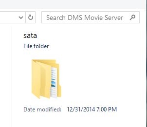

                    I checked my system and I found this date on my 'SATA' folder...
                    I don't think that date is a problem as I have no issues relating to access in my DMS...something else is going on.

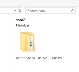

                      Then going into that folder has the date that I last copied content into a folder on that drive...
