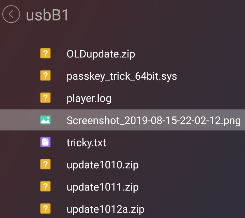

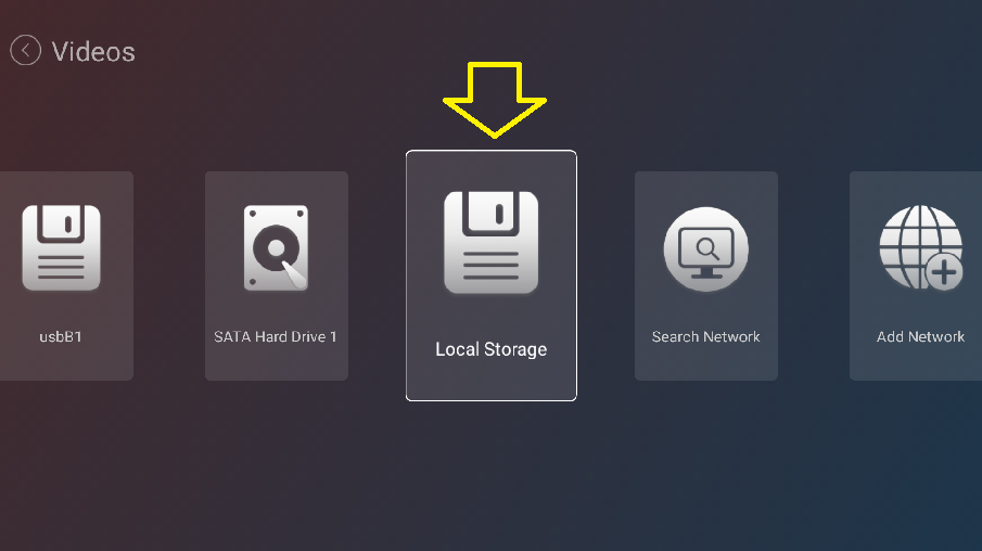

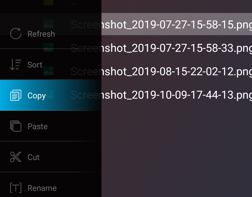

            From the poster wall,select Videos, then Local Storage, then SD Card. then Pictures, the captures are in the Screenshots folder. Highlight the one you want to move then Press the Menu button on the remote (upper left around the circular button) and you will see the menu items shown below. Select the file you want to move (highlight) and click Copy. Now Open the USB drive and click the Menu button again and click Paste. The file will be moved to the USB drive where you can access it from your computer.
            This shows the file on the USB drive on the DMS

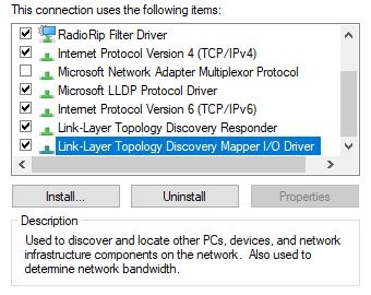

                I'll be the first to admit that I don't know anything about OS-X but it seems to me that if you can open up the main network share but can't drill down any further than that then something is missing or not installed in your network stack...like this...
                Not sure if Apple has such a thing.
