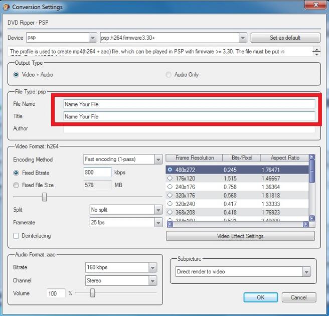

      Rename it here:
        This was on version 8, but version 9 no longer has it.

                It is in Ripper -> Advanced Settings -> Information.

                    You said you were using the Edit button, have you tried what my friend Potti said, using the Advanced Settings->Information button?

                        I click on 'advanced settings' then on 'information'- the filename shows up as
                        'THAT70SSHOW_S5_D4.Title2' and the title as 'THAT70SSHOW_S5_D4.Title2.DVDRip'
                        I highlight and replace with 'That '70's Show - s01e08 Drive-In' in both fields.
