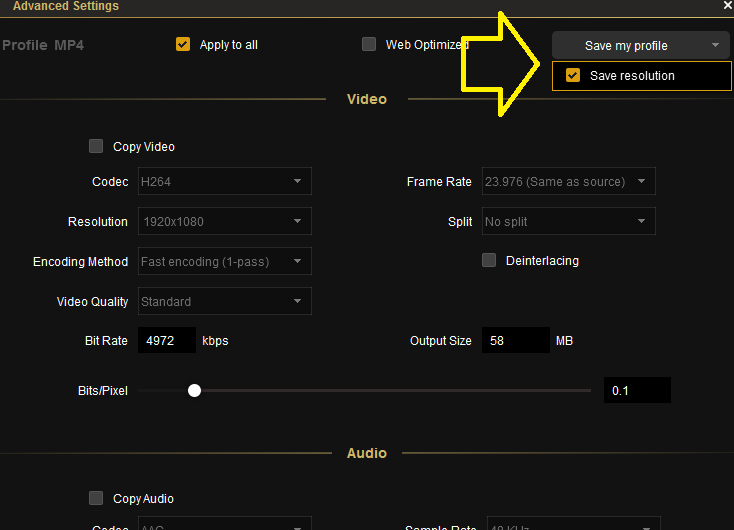

    You can't do that, but you can set a profile and its settings as the default (click 'Save my profile'), to be used whenever you open Ripper or Converter. See the capture. You can choose to check the 'Save Resolution' box if your source files are always the same size, but this can have unpredictable results if the source sizes are different and you have chosen an output size that is not compatible. If you have a file that works well, you can scan it with MediaInfo (free, google it) and see what settings were used, then put them into the Advanced Settings Page.
    Click image for larger version  Name:	1-011ADVSETTINGGS.png Views:	1 Size:	23.8 KB ID:	373689
