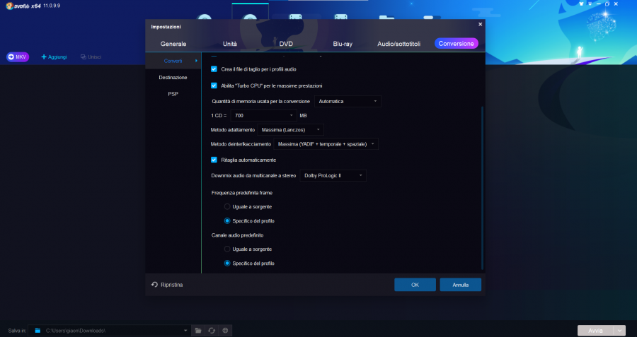

    what changes, at the default frame frequency, equal to the source or specific profile? while at Downmix audio from multichannel to stereo what should I choose between stereo, Dolby Prologic II and Dolby Prologic?

      I put a captured image to understand, what should I choose about the frame, specific to the profile or equal to the source? while for the downmix from multi-channel to stereo?
        1) Same as source, it can be changed on the advanced settings page for each rip for problem discs (unusual).
        2) I use Stereo, since I play rips mostly on iPhones and similar devices, it sounds fine to me but you may prefer to use the Copy Audio setting, which is found (like the frame rate) on the advanced settings page. You can access this page by clicking on the icon that looks like a small wrench after the source file loads. Copy Audio gives the exact same audio that is on the disc but makes the file much larger.
