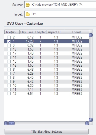

          See the attachment.
          This must be similar to what you are seeing.
          This is 7 episodes of Tom and Jerry cartoons.
          The checked box of 47 min includes all 7 episodes.
          The individual episodes are the 6+ min listing.
          Have you tried to use the preview window to see and select or would just choosing the combined title work for you?
          As far as the extra file you are seeing --there are always files that have nothing to do with the actual episode.

            One thing I've noticed for a lot of TV shows is that you may have one file per episode - and then another huge file with everything in it!
            I believe they use this as a mechanism for "play all" vs playing individual episodes.

              That is what I said and what my attachment shows.
              All 7 episodes are in the title checked and highlighted.
                The "files" are actually Titles and in most cases they don't actually exist as different VOB files. You can verify this with TV episode discs by selecting the Title that has all the episodes, then adding the individual episode Titles one at a time and watching to see if the output size changes in the lower part of the window, near the Quality % readout. If you select the title that contains alll the episodes first, selecting the Titles for each individual episode will not change the output size (or only very little).
