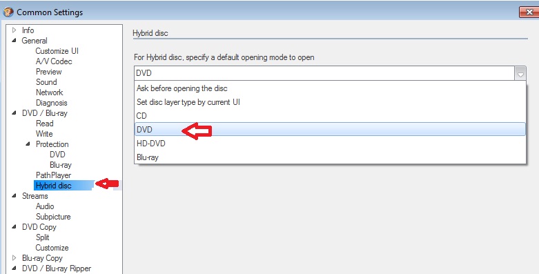

    Check this setting it might help? Haven't run into this yet myself?
      Tried that, no luck.
