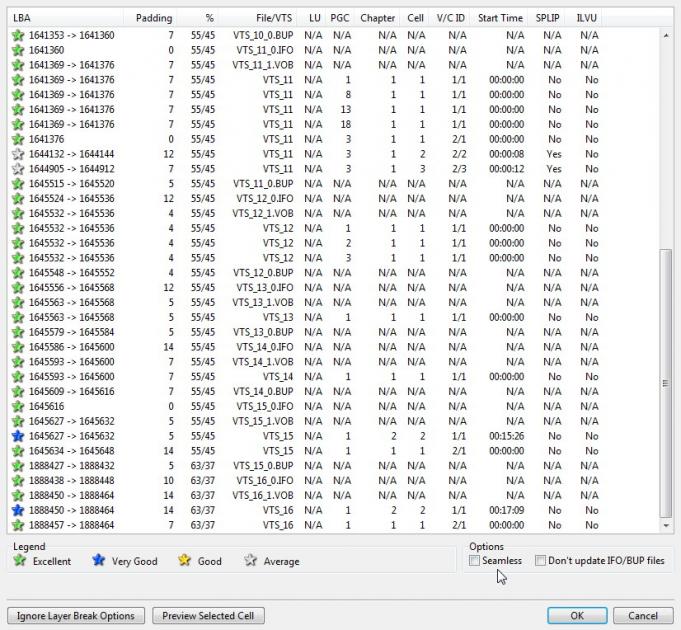

    I really need some help in this area. I got a "WOW" price on a Verbatim DVD+R DL cake box. I am using Imgburn v.2.5.7.0 I have attached a pic of the box where I get "lost". I think I can learn how to find the best layer break position if some on could pick the best one and tell me "why" also for me what would be I looking for "the best" choice. TIA

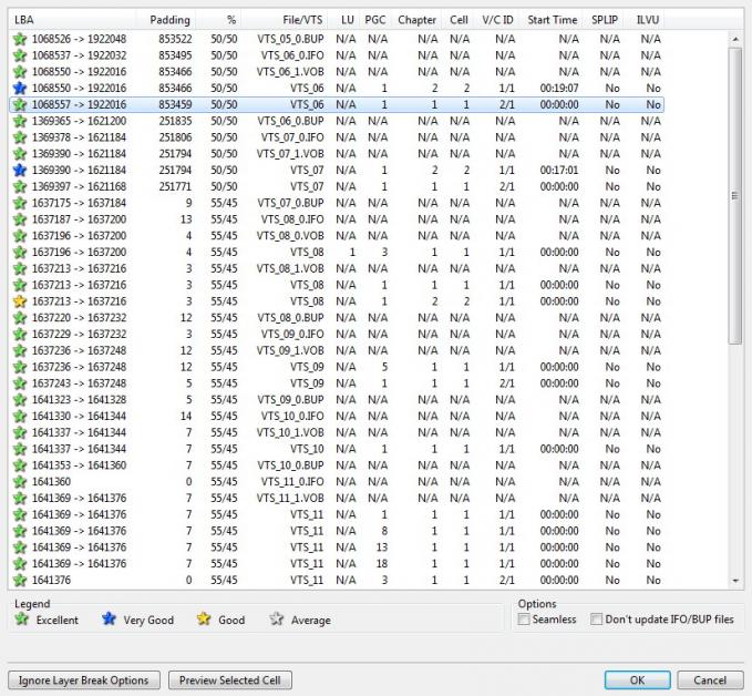

    Criteria one is to get as close to 50/50 as possible and as you also have green dots, a perfect place is to select the layer break between two video title sets. Such as VTS_05 and VTS_06. So select the row VTS_06_0.IFO.

      Thanks for the info, I think I understand now but I get this too:
      I 04:16:48 Optimal L0 Data Zone Method: IFO Cell Boundary, 'SPLIP' Flag Not Set
      How do I fix this? TIA
        If you select a green star - the layer break (SPLIP) is not between two cells, it's between two video title sets.
        You should see a row like this after the build in ImgBurn
        I 13:11:19 Using Layer Break LBA: 1870384 (VTS_05_0.IFO)
        There is also the option to use seamless layer break and most players supports that, the normal delay when the player switches layer shouldn't show up.
        Explained here. in post #14.

            The benefit is that you can specify exactly where you want the layer break to occur when you backup on DVD DL discs and also make the transition between the layers to be seam less.

                For longer movies and Full Disc copies you can tell DVDFab (in Settings) not to remove the layer break information from the original disc. This will often provide a more highly rated choice in ImgBurn.
