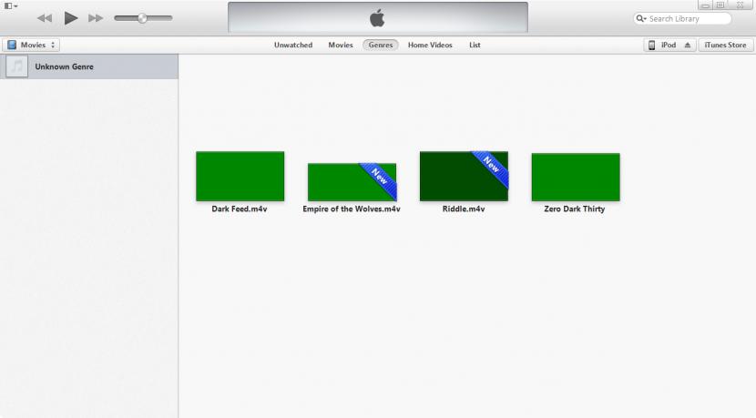

    I noticed when I copied several movies into iTunes that it copies the path name into the file name. For example I just finished encoding a movie into iPod format and called it My.Movie.m4v. When I drag it into my iTunes the file name becomes "C:\Path\To\Movie\My.Movie.m4v". I have changed the name in iTunes but once the movie is copied onto my iPod the movie name remains "C:\Path\To\Movie\My.Movie.m4v". I noticed this change after upgrading to DVDFab ver.9.0.3.2.

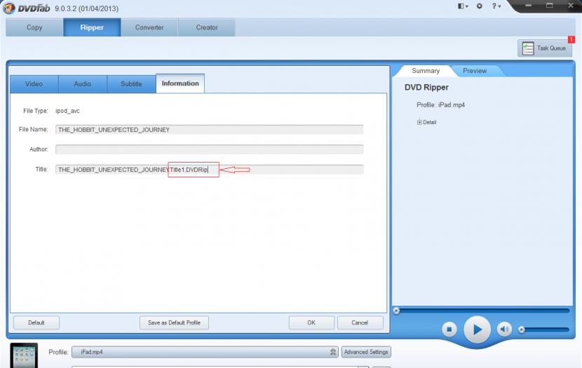

    Try clicking on "Advanced Settings" then Information Tab and removing the bits you don't want.

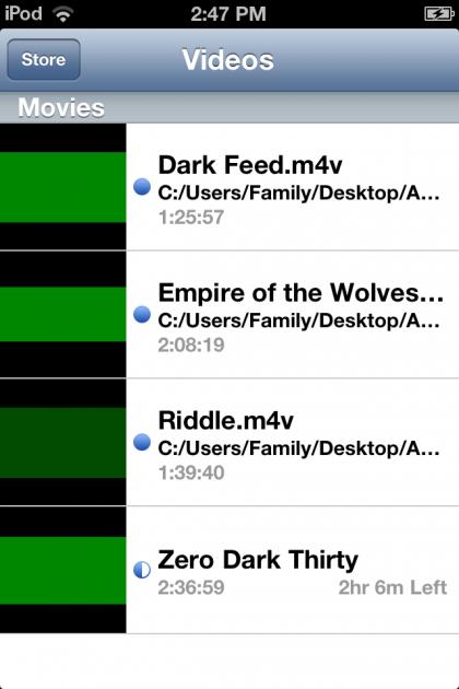

      I do that for every movie I re-encode and in the Windows Output folder it is correct, it's just when I have put it into iTunes or my iPod that the entire path name is shown. I'm currently encoding a movie right now so I can't show you that I have already changed the File name in the Advanced Settings but here is an example of what I am talking about.
      The first picture is of the movie section of my iTunes, the second is of my actual iPod. You can see how the iPod shows the entire path name.
        Yep, you're right I just tried a few chapters and the path is there in iTunes

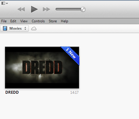

                    I did a couple chapters of DREDD this morning and it is now fixed:
                      Did you use the latest version 9033 to encode them?
                        Yeah sure did, 9.0.3.3
