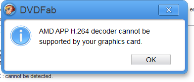

    Your product is not allowing me to use the AMD APP I have on my system, giving me the error shown in the attached image. I of course don't know why, but my guess is because your software is looking at my AMD M880G with ATI Mobility Radeon HD 4250 GPU and thinking it won't work with AMD APP.
    But it does work with it. And here's the kicker. Other Software application recognizes it and uses it. And as you can imagine, the processing times aren't even close. Other Software processes my jobs light years faster with AMD APP than DVDFab does without it.
    But I love your application. I am even trying to sell myself on buying it, even if it ends up taking me weeks/months longer to convert all our discs with it than it would with Other Software. But I just can't quite get past this one issue. Can you help me? Is there something keeping DVDFab from using my AMD APP (even though Other Software uses it just fine) that can be corrected, either on my end or yours? Thanks.

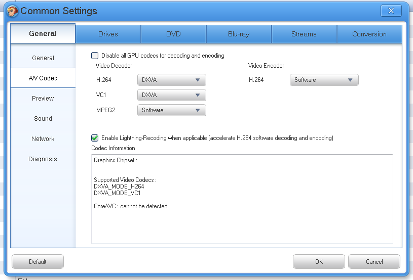

        Thank you for your reply, and my apologies for taking so long to respond. I am brand new to this application, but if I am looking in the right spot, then that setting was already turned on by default. See the attached image, and let me know if that is what you are referring to.
        I know the 4250 is a lower end GPU, but it does work with AMD APP, despite not being listed on their site as one of the GPUs that does (at least mine works with it). And like I said, in the other application I tried, the AMD APP is used, and the difference in processing times is significant. If it's not the AMD APP, then they simply wrote much faster processing software. And theirs has the additional work of converting the audio, which I don't do with DVDFab (that's a major reason I love DVDFab, since it allows me to keep the original audio unchanged, mainly the HD tracks - DTS and Dolby).

          I would set the Decoder and Encoder all to software and leave the Lightning Recording checked.
          Which CPU do you have and how much Ram?
            I'll give that a try next. I have an AMD Phenom(tm) II N660 Dual-Core Processor, 3000 Mhz, 2 Core(s), 2 Logical Processor(s), and 4 GB RAM.

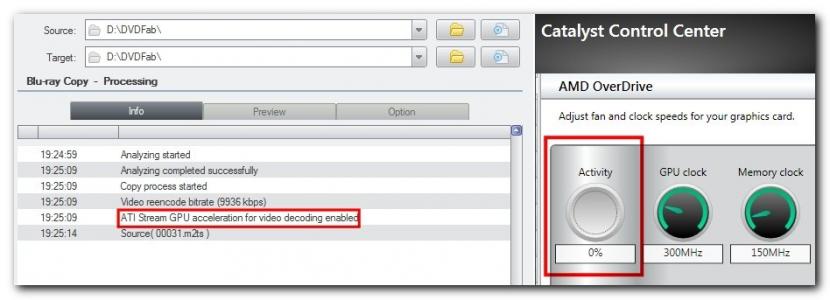

              I run an AMD HD-7770 and I had several email discussions with DVDFab support last year shortly after my purchase of v8 Blu-ray Copy.
              They confirmed that AMD APP (aka ATI Stream) doesn't work: "It's the problem of AMD driver..." Even though my other video re-coding apps recognize and zoom right along using APP.
              Attached is a screen shot (which I sent to DVDFab last year) showing zero GPU activity while converting a BD50 m2ts file to BD9-1080p. The four cores of my i7-3770K fluctuate 80-90%. Other apps run 5-10% CPU and 90-95% GPU.
              When set for DXVA, the GPU runs ~50% while the CPU cores run 40-60%. A 32GB m2ts will compress down to BD9 in about 40 minutes.
              I've confirmed the same for v9.
              I'm of the regarded opinion that DVDFab has no interest in this AMD APP issue. So sad as I'd really like the GPU to handle the full task as well as them informing me "...the decoding speed of ATI Stream is not very faster than DXVA, but it should be more stable than DXVA."
              So just set DVDFab for DXVA and turn off Lightning.

                  I tried running with all decoders/encoders set to software, and with Lightning checked, as you suggested in a previous post, but the processing time was pretty much the same.
                  As to this comment of yours I have quoted here about Quick Sync, were you saying that to me, or to the other person who replied? Because when I try to select the Quick Sync option, I get the same error I get when I try to select the AMD APP option. If you were saying that to me, do you know what I need to do to "get this configured and working", as you suggest? Thanks.

                      The Quick Sync comment was to dallas7, you don't have it on your CPU.
                      I assume you have a notebook with that AMD CPU which isn't very fast. The CPU runs about the same speed as a 2.13GHz Pentium P6200.
                      Unfortunately you are severely under-powered for video processing.
