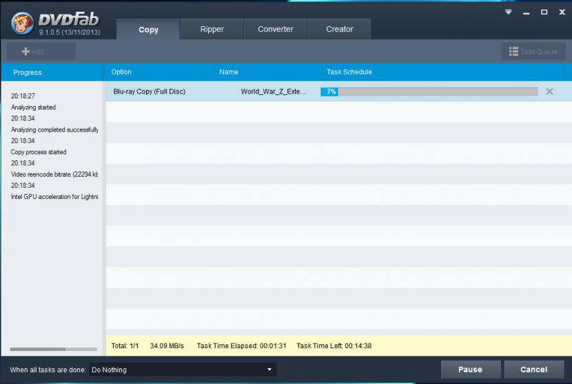

                    I just checked World War Z from the HDD to the HDD will take 15-16 minutes with an i7 3770K and Quick Sync to 25GB.
                    It tailed off a little toward the end and ultimately took 17:19 to complete.

                            You may be able to get that with what you have. Pull that graphics card and plug the monitor into the motherboard, it will load the HD 4000 drivers and make Quick Sync available.
