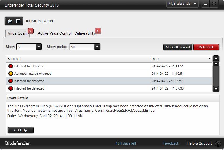

    Upon trying to update from DVDFab9136 to DVDFab9137Beta, I keep getting a virus warning, something to do with the Options folder. Is anyone else having this issue? I have tried both from the automatic update to just downloading and install method.
    Worked fine for me but I'm not using Bitdefender. Is there a way to tell the program that DVDFab is a safe sender?
      I have DVDFab9 9136 and I'm using Bitdefender Total.
      There was a notice, I believe it was from last year, where you could add a link from DVDFab to the execption section of Bitdefender. It permitted access to DVDFab through Bitdefender.
        Yes, I can put an exclusion for the folder in question, but I want to make sure I am not opening the door for a Trojan. That is why I posed the question, "Is anyone else having this issue?" Does this problem maybe have something to do with the changes at DVDFAB regarding decryption, perhaps causing a false positive?
        Just a side note, I have never had an issue with BitDefender before where it concerns DVDFAB, and I have been using them for quite some time.
          I also received the same message using F-Secure Antivirus. I uninstalled 9.1.3.7 Beta and reinstalled 9.1.3.6 with no issues.
