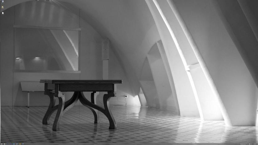

                        I have 20/20 vision, but when you have a 24" monitor running at 3840x2180 everything is really tiny (see attached screenshot - the little dot at the bottom is the Start button). I have a Surface Pro 3 in the post at the moment, which has a 12" screen with a resolution of 2160x1440, which will be an even higher DPI, and I would assume that these high DPI screens are going to be very popular. The only way that anyone is going to be able to use these monitors is to have a larger Text Size.
