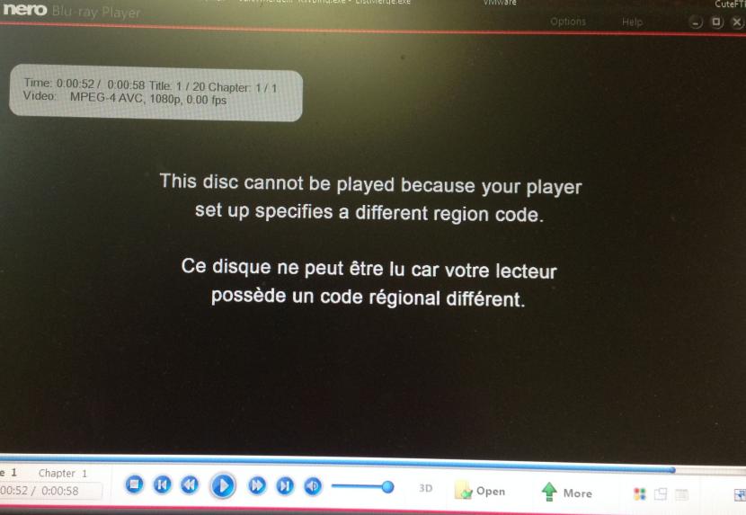

      I'm actually trying to play it on my windows media center pc using Total MediaTheather 5. I also tried on my PC using Nero Blu-Ray Player 12. I also attached a screenshot of what Nero shows.
      the message is exactly the same on both computers ( same image with text ). Looks like it is the disc showing the message because I doesn't detect a region B player and not the player not happy with the disk. Makes sense?

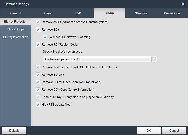

          Open fab ,open common settings , under general..click on top blu ray.... now where it says ....Specify the disc's region code ....open it and choose B Europe etc. Check that all other squares are already ticked ...it should work now.

              Where it says ... Specify the disc's region code ...this has to be set to where the original disc "country" you want to copy is from. FAB should after automatic make the copy region free.
                thanks guys, below is a screenshot of what my setup was. It was suppose to ask me the region code but it didn't.
                I'm changing the setting from "ask" to "region B" and I'm trying another "full disk" copy.

                  No luck with pre-selecting "region B" instead of "ask".
