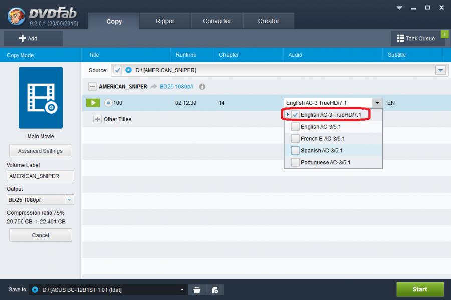

    What is the process to rip 7.1 audio with my movies?. All of them saying audio is 7.1 but it turns out 5.1. Not sure what to do?. I am using Blu Ray copy and converter process and nothing works.

      The movies are in 7.1 but when when I use both Copy or Ripper mode it says only 5.1 can get ripped??

                      I seem to have the same problem. See attached:

                          It was unchecked in common settings and it was an MKV Passthrough, everything same as source. Is that option available in Passthrough?
                            Looks like an MP4? I'll do it again.
