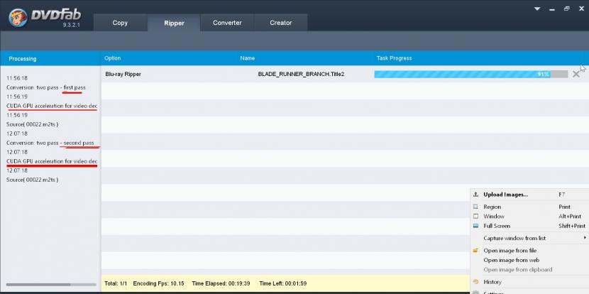

          Strange since 3dman7 says earlier that he was able to get 2 Pass Cuda working but with a bug or maybe he meant that a bug allowed him to do a 2 Pass Cuda.
          Either way, do you know if DVDFab will ever support 2 Pass Cuda ripping?

                The bug and the log files show it also.

                  Looks more like the CPU is doing all the work, not the GPU. FQs19, follow the advice you choose. This has gone on long enough.
