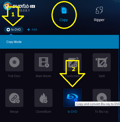

    with version 10.0.8.1, last version I was familiar with was 8.0, I think. Bought this with Blu-ray to DVD, activated, and HD Decrypter, activated.
    Question 1: If I actually want to convert a blu-ray to DVD files on my hard drive, the guides direct me to the COPY section of the main top menu. I expected to be directed to the CONVERTER section; if that's not what I want in order to convert a bluray to a dvd, then why is it called Converter? Am I using the right tools/guides?

    1) Converter only works with video files like AVI, MP4, MKV etc as Sources and outputs. To convert the disc structure, you need to use the Blu-ray to DVD option which you purchased. You can find it here using the Mode Selector:
    Click image for larger version  Name:	1-011 BD2DVD2.png Views:	1 Size:	72.1 KB ID:	349854
