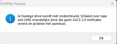

    Hello, i have a Blu-Ray writer which can read 4K but here comes the problem: The latest DVDFab Passkey gives an error while
    reading the disc
ID:	422842So whats next?

                      The link to the Fab drive tool indicates what drives are supported by this program - and your Pioneer drive is not on the list, so no surprise there.
