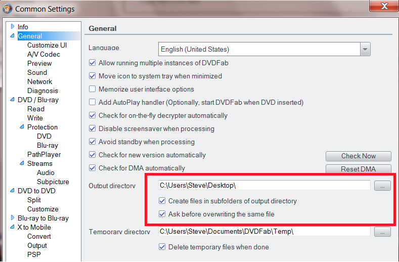

Mine too, I set it like in the attached picture and it stays:How to post the internal log
I just found something interesting, the default output directory sticks in Windows 7 but nothing I can do will make it stick in the Vista machineHow to post the internal log

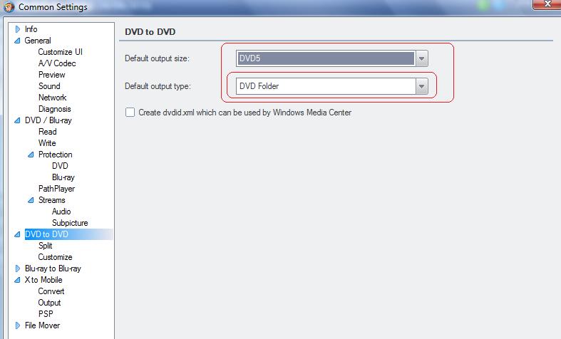

Originally posted by 90312 View PostOk Comedyfan I found it, starting to feel like a noob here! When you set the the directory in the "General" settings you have to go on down to "DVD to DVD" and set the type to a folder and it will stick for you. See the attachment:
I do not remember having to make that selection on v6 but whateve--r it works now.
Yeah, like I said I was scratching my head and feeling like a noob! sometimes you just trip over the solution.How to post the internal log
