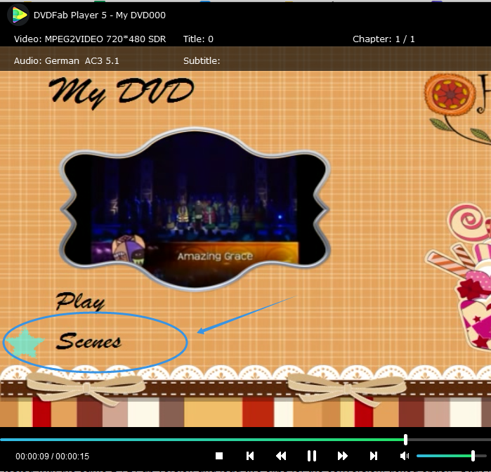

    --I've tested with the same DVDFab version and loaded two clips for the conversion, ticked option "Start from Menu and play titles sequentially", used DVDFab Player 5 and VLC as playback software, menu mode, I can witch to the sub menu using the “scenes” button under the "Play" button
    Click image for larger version  Name:	scenes.png Views:	1 Size:	460.2 KB ID:	359133
    I've also tried your way of uncheck both options under Playback Mode, the resulted DVD will playback from the first title and then to the second title.

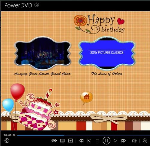

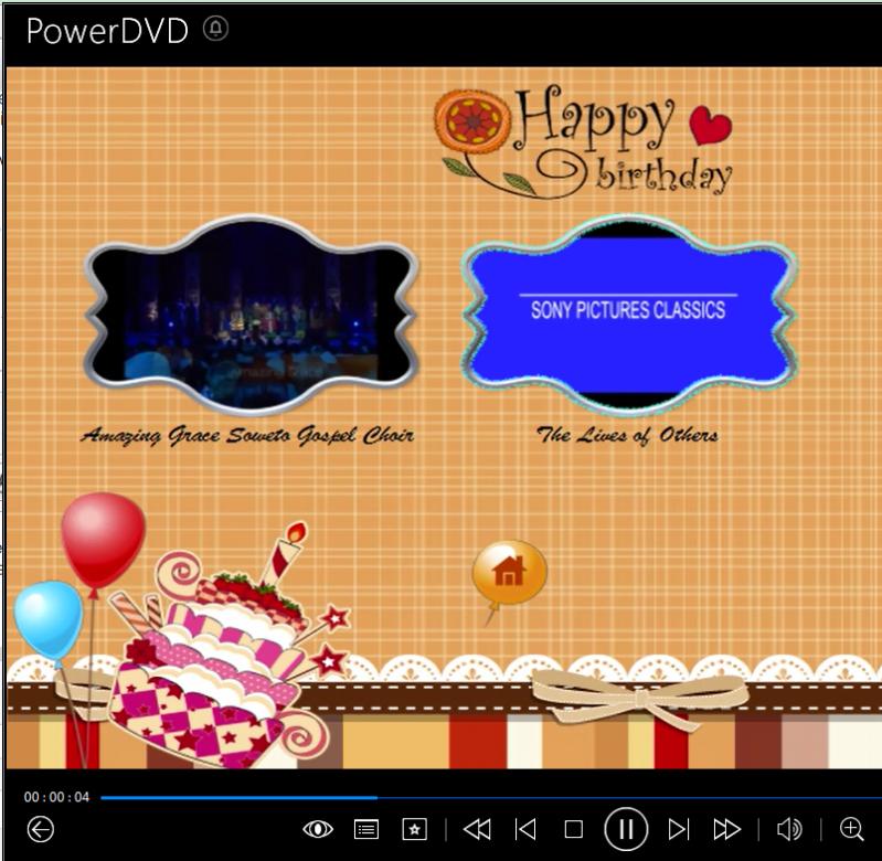

          I am using Cyberlink to view the disk. I get a similar screen to the one that you show, in that it only shows one title. the titles play sequentially (first then second) whether I click the picture, or select Play. No option is offered to play just the second clip or just the first clip.
          Switch to the Scenes option, it shall display the second title. See example. You can click on the second one to play it directly.
          Click image for larger version  Name:	scenes.png Views:	1 Size:	91.1 KB ID:	359228
          Id like to have the opening menu show both titles, and be allowed to play only the one that I select. I have seen this menu format play out using Cyberlink, but it has always been with store bought DVDs of TV Seasons. In those cases I have had the OPTION to have all episodes play sequentially, but I generally chose only the episode I want. I can live with having sequential play as an OPTION on my disk, but prefer that it not be the Default Option and definitely not the only Option.
          Our developers are working on improving the menu feature of Creator. About your feature request of "have the opening menu show both titles", I will pass it to the product manager first. Thanks.
