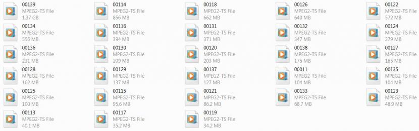

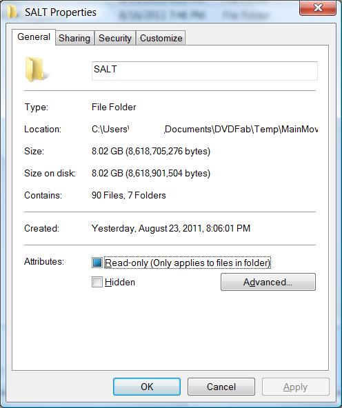

            maineman,
            Please see screenshots. Is this what you are looking for? Hope this helps.

                Originally posted by DVDFabLover2011 View Post
                maineman,
                Yup, thanks.
                It helps and confirms what I suspected based on your logs.
                The software is failing to compress adquately to fit on a DL disc..
                If we do the math...
                8,618,901,504 bytes = 8,219 MB (or 8220 rounded up)
                same as your logs
                181m 27.52s: compress finished: groups request(8019 MB) real(8219 MB)
